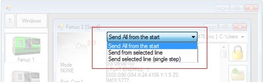

When I select send all from selected line (or even to send a single line) the program is sent from the beginning to the machine, and machine begins from the first line.
To make sure I am doing it correct: I scroll down the code and find the operation I want to restart from and select/highlight the text of the line, and then click send. I've also tried placing the cursor just before the line and click send. It always starts from the 1st line.
Does anyone know how I can make this work?
Thanks
By: SupportPosted on: Mar 19 2019 at 02:24:14 AM
On the send window did you also change this option? The default is to send the whole program from the strat but you need to change that to "Send From selected line" (The second option in this picture)
